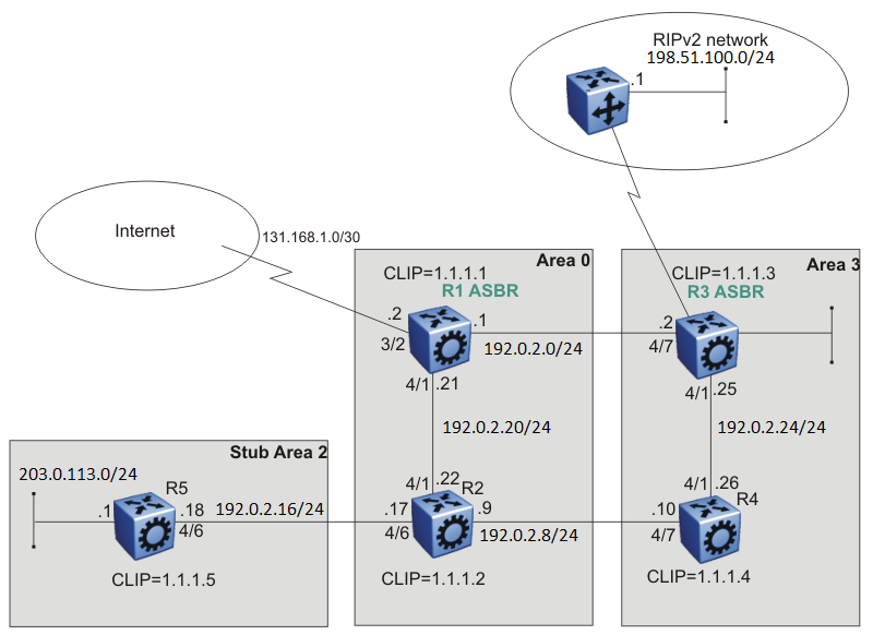

The following figure shows five devices (R1 to R5) in a multi-area configuration.
The following list explains the configuration for devices R1 through R5:
R1 is an OSPF AS boundary router (ASBR) that is associated with OSPF Area 0 and OSPF Area 3. R1 distributes a default route for Internet traffic.
R2 is an OSPF stub ABR for OSPF Area 2 and ABR to OSPF Area 3.
R3 is an OSPF ASBR and distributes OSPF to RIP and RIP to OSPF.
R4 is an OSPF internal router in Area 3.
R5 is an internal OSPF subrouter in Area 2.
All OSPF interfaces are brouter ports except R5.
Network 203.0.113.0/24 on R5 uses a VLAN configuration instead of a brouter port. This example uses brouter ports rather than VLANs because the spanning tree algorithm is disabled by default if you use brouter interfaces.
All interfaces are Ethernet; therefore, the OSPF interfaces are broadcast, except the circuitless IP (CLIP) interfaces, which are passive.
The interface priority on R5 is 0; therefore, R5 cannot become a DR.
Configure the OSPF router priority so that R1 becomes the DR (priority 100) and R2 becomes the backup designated router (BDR) with a priority value of 50.
Use stub or NSSA areas to reduce the LSDB size by excluding external LSAs. The stub ABR advertises a default route into the stub area for all external routes.
